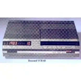

BeoCord VCR60
The next stage in B&O’s foray into the V2000 technology, this machine was based on a Grundig machine and was not sold in the UK.
