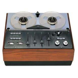

Beocord Stereomaster was a reel-to-reel tape recorder which was novel for its time in that it had an Automatic Stop Function for if the tape should break during play. There were two variations – Type T was designed to be transportable; Type K was designed for a more static position. The tape recorder is ready […]
The tape recorder is ready just to plug in as the connections have been built in the bottom of the furniture cabinet.
The new B&O Beocord Stereomaster Tape Recorder is the ideal recorder for the discriminating tape amateur. For the first time in the world you can have an amateur tape recorder with a built-in mixing panel for simultaneous mixing of three input signals.
Here, for the first time, is an all-transistor Hi-Fi tape recorder comprehensive professional specifications, including:
Synchronous motor of the Pabst type
Separate recording and playback heads
Recording quality may be checked at any time, either before recording (at the recording amplifier output) or after (at the tape monitoring amplifier output)
Equipped with two V. U. meters.
Three dual-input channels with slide-potentiometer adjustment.
Professional standards for speed, wow and flutter.
Release Date:1963, 1964
Signal-to-noise ratio 1/2 track: better than 55 dB
1/4 track Better than 50 dB
Power Consumption, Motor 27 W
Power Consumption, Amplifier No signal: 8W. Full volume: 20W
Bias Current, AMPEX 521 ½ track: 2,3 mA. 1/4 track: 1,9 mA
BASF LGS 35 ½ track: 2,6 mA. 1/4 track: 2,1 mA
Recording Characteristic DIN 1962
Channel Separation Better than 45 dB
Supply Voltage Switchable between 95, 110, 125, 205, 220 and 235 V, 50 c/s
Erase Frequency 100 kc/s
Reel Diameter Max. 18 cm
Number of tracks 2 or 4 tracks
Tone Control Range + 10 dB at 50 c/s
+ 10 dB at 10,000 c/s
Power output 22 8W, harmonic distortion < 1% at 5 W
Line output voltage 800 mV + 4 dB (47 k ohms)
External speaker Impedance: 4 ohms
Weight Type K: 16 kg
Type T: 18 kg
Dimensions, Type T (Transportable model)
45 cm width
35 cm depth
Height inclusive of speakers: 27cm
Height exclusive of speakers: 19cm
Dimensions, Type K
45 cm width
35,5 cm depth
Height inclusive of lid: 21cm
