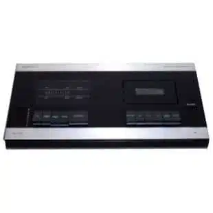

BeoCord 1700 (1981)
Beocord 1700 matched the Beomaster 1700 both physically and technically. It combined high performance with easy, straightforward operation.
Ferric, chrome or metal tapes could be used. The Sendust tape head, Dolby B circuits and Peak Programme Meter all contributed to high quality recording and playback. You could switch between all modes of play without fear of tangling the tape or damaging the mechanism.

BeoCord 1700 (1981) Product Specification
Compact cassette: C46-C60-C90
Tape head: Sendust
Noise reduction: Dolby NR
Tape switch: Auto. ferro/chrom
Wow and flutter DIN: <+/- 0.15%
Speed deviation: <+/- 1%
Fast forward and rewind: C60 90 sec
Frequency range chrome/metal/ferro: 30 – 16,000 Hz +/- 3 dB with MPX filter
Signal-to-noise ratio metal Dolby NR: >66 dB
Signal-to-noise ratio chrome Dolby NR: >64 dB
Signal-to-noise ratio ferro Dolby NR: >62 dB
Power supply:
2662 220V
2666 240V
Power consumption: 20 W
Dimensions W x H x D: 40 x 10 x 26cm
Weight: 5 kg
Connections: Microphone 0,3 mV /3,3 Komhs
