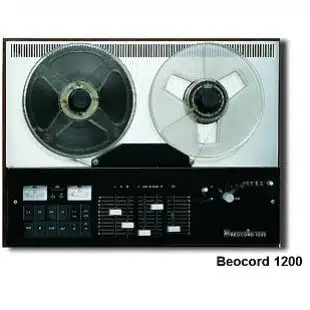

Beocord 1200 Type 4207 was a reel-to-reel tape recorder. Among its features it had sound-on-sound, automatic recording level control and mixing. The in-built PA amplifier could be operated without the motor running. Beosystem 1200 – made up ofย Beomaster 1200, Beocord 1200 andย Beogram 1200ย was Bang & Olufsen’s B&Oโ€™s first designed system. The design ‘kinship’, which emphasised […]
