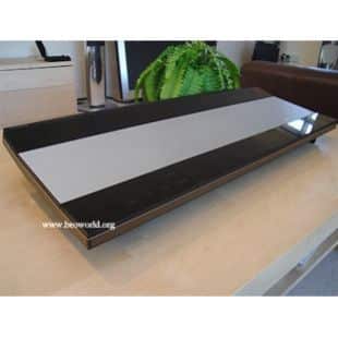

In the BeoCenter 9000 Jensen radicalised the basic ideas that had asserted themselves in the BeoMaster 1900. It was given two ‘angles’ but it is close to being merely a horizontal, floating, blank surface. The flush concept was taken a step further: now everything is entirely flat, nothing projects. Not even the lids on the CD player and the tape recorder rise at any time above their own level, but slip quickly and noiselessly to one side. Communication with the apparatus is reduced to two black glass sheets, one for input and one for output.
The cool, clean design – at once both peaceful and effective in appearance – reflects the rational operation, which is carried out via microprocessors. With the Beomaster 1900’s division into primary and secondary operation facilities, Jensen had anticipated the computer interface of the IT age, in which priority is given to the potential of the function selector.
The Beocenter 9000 is electronic through and through: the operating instructions for the relatively complicated apparatus with its many functions are built into the control equipment. Only the entirely everyday basic functions are visible in standby. When they are touched gently, the upper glass sheet – the ‘magic mirror’ – lights up. Several possible choices emerge only when they are needed.
The best and most consummate Jensen make the user feel like a magician. It was really Jensen’s wish that the lids on the BeoCenter 9000 should slide aside entirely without being touched when a hand came close to them, but that visionary idea was difficult to realise because it would mean the lids would open, for instance, when you merely wanted to change the volume. The designer David Lewis solved that problem when he designed B&O’s next breakthrough product, the upright BeoCenter 2500 (1991). He hid all buttons behind the lids. Lewis took his further development of Jensen’s B&O audio design profile in other directions when Jensen cease designing for the company in about 1990. By then, Jensen had designed more than 100 products for B&O. The reason for B&O’s success in the 1970′ and 1980s was the management’s willingness to aim at and realise risk-filled, pioneering strategy.

The lid of the Beocenter 9000 disappears into the side of the apparatus and makes the user feel like the hero of a science fiction film. The plus values of products cannot be created on the background of qualitative or quantitative marketing surveys. Jensen’s role as the man who reads the trends of the time and uses his intuition to fulfil consumers’ unconscious wishes gives him a special role as an artist in product development.
