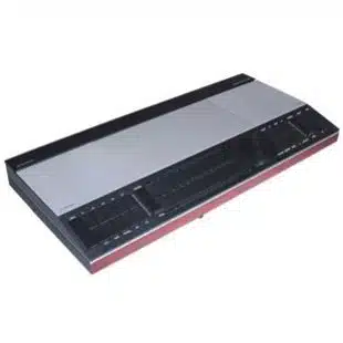

Beocenter 4000 was an elegant combination of an AM/FM stereo receiver (in effect theย Beomaster 2200) and a high quality cassette deck whose performance levels matched those of more expensive separate decks. The Sendust tape head ensured the best possible playback and combined long life with optimum frequency response characteristics. There were two motors – one […]
Beocenter 4000 was an elegant combination of an AM/FM stereo receiver (in effect theย Beomaster 2200) and a high quality cassette deck whose performance levels matched those of more expensive separate decks. The Sendust tape head ensured the best possible playback and combined long life with optimum frequency response characteristics. There were two motors – one for fast wind, the other for normal play – so tape transport was smooth and stable at all times. A Dolby B Noise Reduction circuit ensured high quality, low-noise recordings. Despite its many technical refinements and comprehensive facilities, Beocenter 4000 was simple to operate.
Beocenter 4000, in which all parameters concentrate on the quality of radio and tape reproduction, was an unusual alternative to a disc system. The addition of a matching Beogram from the Bang & Olufsen range, plus twoย Beovox S45ย bookshelf orย P45ย wall-mounting speakers converted it into the complete top-quality Beosystem 4000.
Beocenter 4000 comprised a 2 x 40 watts RMS amplifier, an FM, Long and Medium wave radio and a stereo cassette deck incorporating all the features you would expect to find only in separate high quality decks.
Type Number:1603
Release Date:1978, 1979, 1980
Designer:Jacob Jensen
Colour / Finish:Oak, Rosewood, Teak, White
Power output 2 x 40 watts / 4 ohms
2 x 30 watts / 8 ohms
Music power 2 x 75 watts / 4 ohms
2 x 40 watts / 8 ohms
Speaker impedance 4 ohms
Harmonic distortion < 0.05 %
Intermodulation < 0.1 %
Frequency range 20 โ€“ 30,000 Hz
Signal-to-noise ratio pickup low impedance > 60 dB
Bass control at 40 Hz: +/- 12 dB
Treble control at 12,500 Hz: +/- 12 dB
Tuner:
FM tuner range 87.5 โ€“ 108 MHz
LW 147 โ€“ 350 kHz
MW 520 โ€“ 1610 kHz Cassette:
C60 โ€“ C90
Wow and flutter < +/- 0.15 %
Speed deviation < +/- 1.5 %
Fast forward/rewind 80 sec
Frequency range chrome 30 โ€“ 15.000 Hz
Signal-to-noise ratio chrome > 58 dB
Dolby NR chrome > 66 dB
Power supply:
110 โ€“ 130 โ€“ 220 โ€“ 240 V
Power consumption 20 โ€“ 200 W
Dimensions W x H x D 65.5 x 8.5 x 31cm
Weight 15 kg
