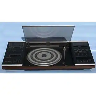

BeoCenter 2002
BeoCenter 2002 Product Details
Type Numbers
2101 (1981 - Feb 1982)
Designer
Please let us know
Manufactured
1981 - 1982
Colour Options
Plastic wood
BeoCenter 2002 Product Specification
Power output RMS DIN: 2 x 25 watts / 4 ohms
2 x 20 watts / 8 ohms
Harmonic distortion -26 dB < 0.15%
Harmonic distortion < 0.2%
Intermodulation < 0.4%
Frequency range +/- 1.5 dB 20 – 25,000 Hz
Damping factor > 30
Input tape copy 600mV / 15 kohms
Signal-to-noise ratio phono > 78 dB
Output external tape 30 mV / 100 kohms
Output headphone Max. 2.8 V / 22 ohms
Channel separation 1000 Hz > 50 dB
Bass control at 40 Hz +/- 14 dB
Treble control at 12.500 Hz +/- 14 dB
Tuner:
FM range 87.5 – 108 MHz
AM range LW 147 – 350 kHz
AM range MW 520 – 1610 kHz
Power supply: 110 – 130 – 220 – 240 V
Power consumption: 18 – 135 W
Dimensions W x H x D: 73.5 x 12.5 x 38cm
Weight:11.2 kg
Record player:
MMC 20S
Stylus Spherical diamond
Radius of curvature 15 µm
Recommended tracking force 15 mN / 1.5 gram
Frequency range 20 – 20,000 Hz +/- 3 dB
Speeds 33 – 45 rev. / min.
Wow and flutter, DIN < +/- 0.09%
Wow and flutter, WRMS < +/- 0.045%
Rumble weighted > 62 dB
Rumble unweighted > 42 dB
Tape Recorder:
Compact cassette C60 – C90
Tape head Super Permalloy
Noise reduction Dolby NR
Tape switch Manual ferro-chrom
Wow and flutter < +/- 0.2 %
Speed deviation < +/- 1.5%
Fast forward and rewind C60 75 sec.
Frequency range ferro-chrome 30 – 14,000 Hz
Signal-to-noise ratio Chrome Dolby NR > 63 dB
Chrom > 56 dB
Connections: headphones, microphone
