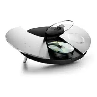

The Socket Unit contains most of the electronics, as well as all external connections. This greatly helps the organising and concealment of the numerous cables needed in a typical A/V set-up. In BeoCenter 2 only a single thin cable, available in 1.8, 3, 5 and 10 metre lengths, connects the Master Unit to the Socket […]
The Socket Unit contains most of the electronics, as well as all external connections. This greatly helps the organising and concealment of the numerous cables needed in a typical A/V set-up. In BeoCenter 2 only a single thin cable, available in 1.8, 3, 5 and 10 metre lengths, connects the Master Unit to the Socket Unit. A 1.8 metre cable is delivered as standard.
The Socket Unit is fitted with MasterLink, RGB, PowerLink, power connections and other connectors so that you may connect a pair of BeoLab active speakers or link it to a home cinema system.
A great advantage of the compactness and relative lightness of the BeoCenter 2 Master Unit is great flexibility in placement. It can be wall mounted, attached to a dedicated floor or table stand, or simply placed on a table or shelf.
Digital Radio Module
BeoCenter 2 DAB digital radio module: this module allows users access to terrestrial free-to-air broadcasting of high quality audio and data. DAB digital radio is a new way of broadcasting radio via a network of terrestrial transmitters. It provides listeners with more choice, better sound quality and more information. DAB digital radio is like analogue radio, only much better. When available – from 3 November 2004 – the module will become a standard feature of BeoCenter 2 in the UK.
In order to make the module compatible it has been necessary to update both the Socket Unit and the Master Unit. This, however, means that DAB will not be available with past and current BeoCenter 2 models. It was originally stated upon the launch of BeoCenter 2, that it would be possible to ‘upgrade’ to DAB. Where customers purchased the model on that understanding, Bang & Olufsen will honour that commitment. The first Master Unit serial number with software suitable for the DAB functionality is 18139286.
Note: To have the DAB module fitted to your BeoCenter 2 is essential that both the Socket Unit and Master unit are the latest versions. Mixing existing stock of Master Units (pre-serial number 18139286) and DAB Socket Units (part number 1280020) is not possible.
Master unit connections: MasterLink x 1, Digital Out, SCART, S-VHS, FM Aerial, AM Aerial, audio in (L&R), audio out (L&R), PowerLink x 1 (See Specifications).
By touching ‘load’ on the anodised aluminium top panel, BeoCenter 2 opens to receive your chosen media. The product is made up of two units linked together by a special cable: the Master Unit (or Media Unit which is the player itself) and the Socket Unit.
