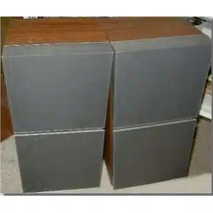

Uncommon in the UK, the smallest of the range at the time and a two way speaker. Replaced by the S45 which was also downgraded in comparison with a captive lead.
