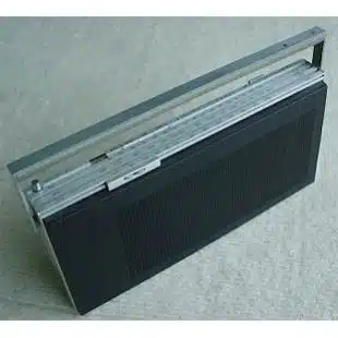

Rayner Banham was one of the first to acknowledge that the youth and pop culture had the same artistic value as that all too objective modernistic demonstrating an anonymous anti-design. The first portable transistor radios appeared at the end of the 1950s, and during the 1960s they became part of youth culture. The early portable radios, including those from B&O, looked like ladiesโ€™ handbags and were anything but exclusive.
The Beolit 600 is an example of how Jensen goes in exactly the opposite direction from his competitors. Now the radio has become a design icon, a cult object, but in reality is something as banal as a redesign of B&Oโ€™s earlier, somewhat uninteresting, wood-clad transistor model โ€“ the Beolit 1000. Jensen compressed the cabinet until it was completely flat, very long and not very deep โ€“ an exciting and very architectonic shape. The openings for the loudspeakers were square and together constituted an asymmetrically placed rectangle.
People would take the transistor radio to the beach, so Jensen did what he could to make is sand proof and robust. A Plexiglas plate would not be appropriate, as it would be scratched if sand got underneath it. Jensen had the idea of taking the indicator down into the actual aluminium profile. It became a metal ball down in a groove. Jensenโ€™s friend, the brilliant engineer Karl Gustav Zeuthen (the creator of Danish KZ aeroplanes), developed the system so that a magnet dragged the ball along down in the aluminium profile โ€“ flush again.
The sandwich construction consists of two plastic trays that can be removed in order to change batteries. They click into place on the aluminium frame. The plastic had a special velvety texture, a rough effect exuding quality. The model in black resembles charcoal. A smart detail is in the handle which can be tipped to one side as a support so that the radio can conveniently lie obliquely with the controls in front of you or on your work desk. After one of B&Oโ€™s factory buildings burned down, one of the employees happened to switch on a Beolit that had completely melted down and it played quite happily in spite of it all! โ€ taken from โ€˜Jacob Jensenโ€™ by Christain Holmsted Olesen.
